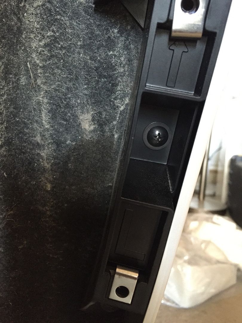

The first step is to remove two Phillips head screws inside the fender liner and pull it back. This will give you access to three predrilled holes.
You will need to put one of the metal clips over the middle hole.
In the bag with each splash guard there will be a mount. Two metal clips need to go over the two holes on the mount.
Realign the fender liner and line up the mount over the predrilled holes. There will also be the middle screw that needs to be added to the two originals.
Before the mud guard is put on, a metal clip needs to be put over a predrilled hole in the fender liner towards the inside of the car.
Another metal clip needs to be added to the underside of the splash guard.
At this point the splash guard is ready to be mounted to the car. Align the splash guard to the holes and thread the screws on without tightening them. This is important to make sure there are no gaps against the car. There are three screws on the inside of the splash guard as well as one underneath.
Line the splash guard up against the car to ensure there are no gaps and tighten the screws. Start with the top one on the inside and work your way down. The one underneath should be last.

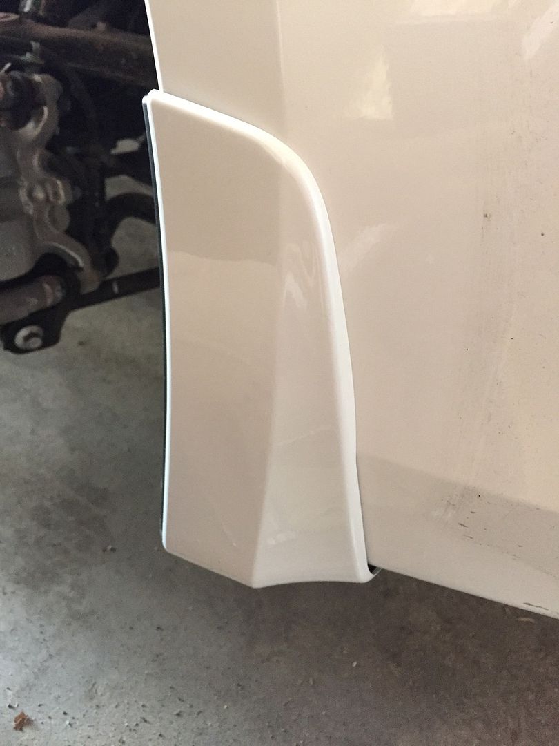

Repeat for the other side and hopefully the end product will look like this.....without the dirt of course.

Just an FYI - on your last photo of the Rear Splash Guard on the car, you have it mounted wrong - the tab with the clip you installed goes OVER the lip on the rear bumper, you have it UNDER the bumper.
The clip doesn't hold anything as the hole in the bumper is above it and after the screw goes in (if that makes and sense ) :)

It was very easy. The only hiccup apparently was that I didn't tuck the bottom under the bumper. I'll speak to the head mechanic out in the garage a bit later about that. ;).
