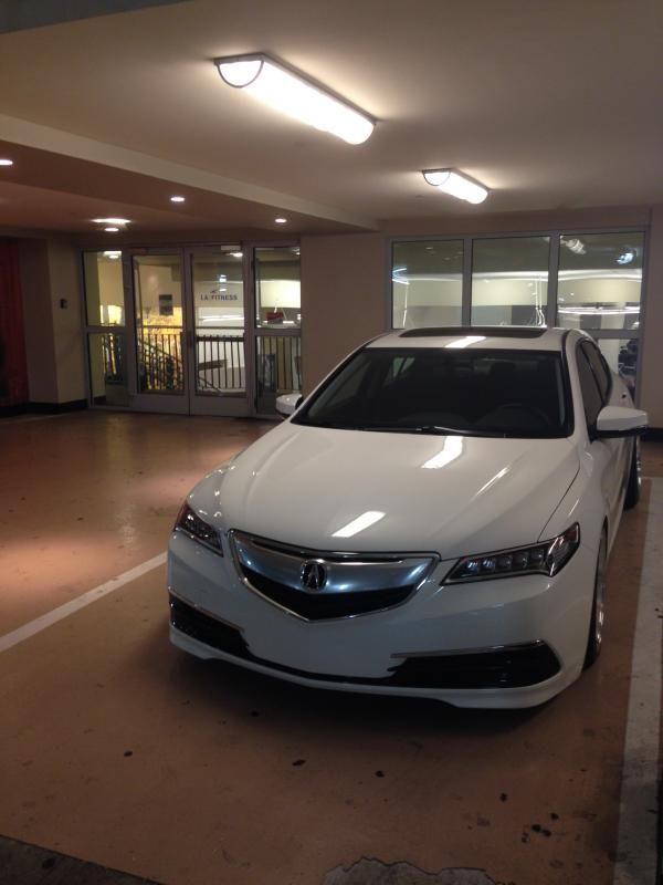

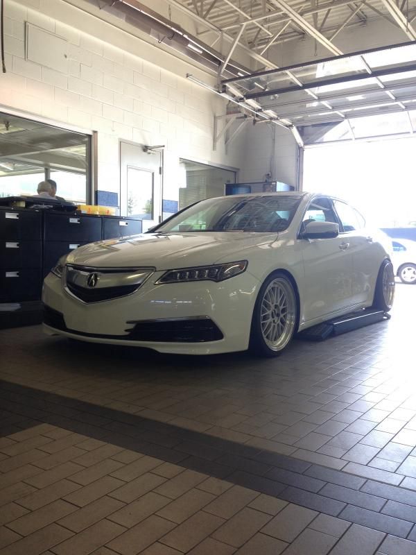

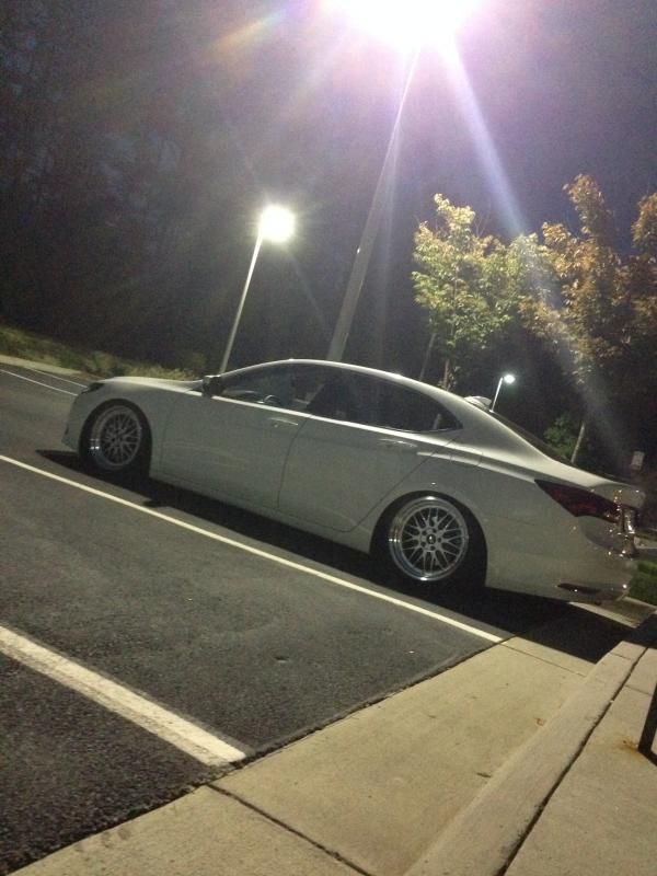

Hello fellow TLX owners. I'm Xavier, and I recently acquired my 2015 Bellanova White TLX DCT. I purchased it in October from the dealership that I work at, Rosenthal Acura in Gaithersburg MD. I have been a Certified Acura Technician for Honda and Acura for the past 11 years, and love owning these cars, and working on them. Below are some pictures of my TLX and what I have done to it thus far. (all with less than 100 miles on the odometer!)
I had to do some backyard engineering to get everything to work, but thanks to my buddy at Honda R&D, I was able to confirm that the suspension geometry and pick up points of the TLX are shared with the '13-'14 Accord, which in turn, would mean that coilovers for the accord would work on the TLX. So the mod list so far is:
-Megan Racing EZ street coilovers ('13-'15 Accord)
-19" ESM BBS LM replica wheels 19x8.5+35 and 19x9.5+22
-5mm and 15mm spacers makes offset a +30 and +7
Next I plan on installing the optional front lip spoiler, side skirts and rear bumper trim.

What a coincidence... I saw you driving in Gburg this morning and was thinking man, someone modded a TLX already? And here you are on the forum. Great looking TLX! Maybe it'll open more doors here for folks to start modding. I plan on staying stock though :)

Not a fan that those wheels are knockoffs but still, they look great!
What else do you plan on doing to your TLX?
Yea... not about to spend $4,000.00 on some authentic BBS LM's for my daily driver. I got the wheels from a friend at a crackhead price including tires, so I just jumped on them. I got my other toy to put the authentic parts on.
As far as other plans for the car, I came from a '13 TSX SE and really loved the interior of that car. So maybe a black headliner, Black A/B/C pillars, amber ambient and footwell lighting...easy stuff.

Forgot to mention that the shop looks really spotless and super clean; can almost eat off the floor. Not every place is like that. It must be really great to work there.
